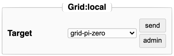

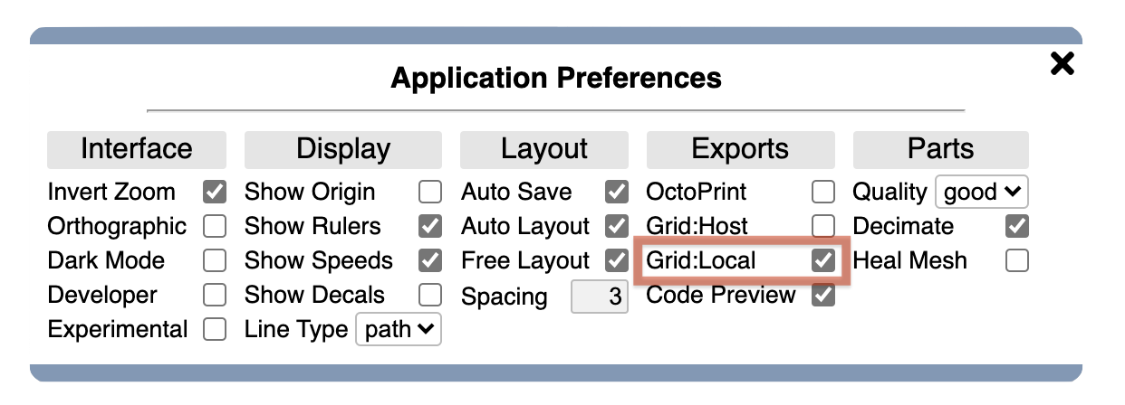

Available through the OctoPrint plugin interface and on GitHub, this plugin allow zero-configuration printing to any local OctoPrint server directly from Kiri:Moto. Grid:Local must be selected under Preferences for local servers to show up in the export dialog.
The send button will spool a print directly to OctoPrint where it will sit under local Files. The admin button will open a browser window to the OctoPrint interface.

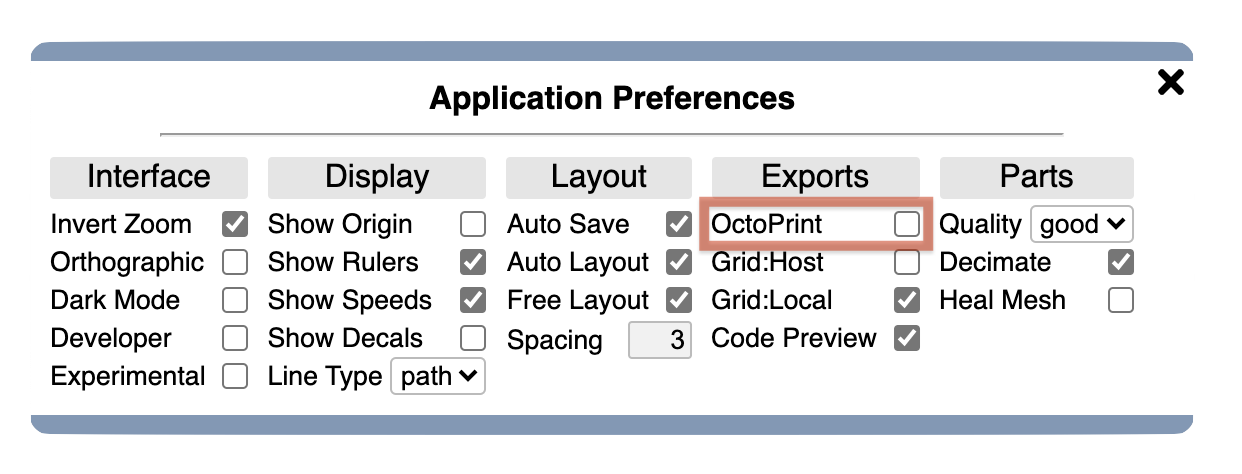

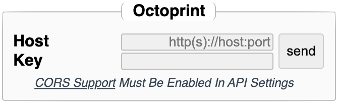

OctoPrint has a web api endpoint that can be configured on Export when enabled.
This will result in the following dialog section to appear in the export dialog.
